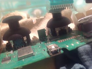

well it do my dident start so do this open the controller and the start and other cable isent 100% forsed to the bord i did reatatch it and it wirks like new

easy sony made me a bit upset when i opend my 3 controller that stopt do anything turns out sony made the bord work if the keypad is forced on it if a bit not it whont do anything try aline it again and hold it and have power in it too and if you forced it right it start all 4 red led lights and you have it working like new hope this is the same that happend to you its a cheap by sony but its not worth pay for reset the cable when you can do it yourself
this is the fix to the problem
. this is the cable in the problem

its the sony who made a stupid idea if the start buttuns cable arent tutching it good it whont let it charge or start force it down and have the usb in it and see if it starts flach red oh and battery isent nedded to work cuz it works if the cable is in
