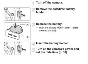

Camera won't hold date Has to be put in every time camera is turned on. Can this be fixed
Mike, sounds like your RTC battery is depleted. I would start with that. Canon calls them Date/Time battery.
Thank you, I will change the batterie.
