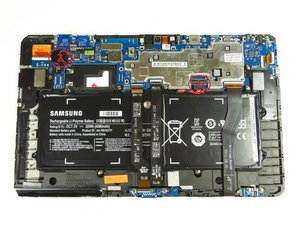

I try to charge up my ATIV smart pc 500t over night and still see no light and can not start up.
please help

Same problem, I think windows update bricked it, last night I've updated my tablet and when I woke up it wont power on, no light indicator, and it wont charge. Someone please help us!
Same problem here too.
After I upgraded to Win 10 after a while it says Batterie low please charge (plug in AC message).
I let it run out so I could make a full charge.
But when it boots down itself cause of low Power, it shows the same symptom.
No reaction on Power button or charger. No LED lights up. Like dead

I've changed the bios battery with no luck. I've already ordered the main battery, now waiting for the shipping from shenzen....i'll let you all know

Check out our Samsung ATIV Smart PC 500T Troubleshooting for possible causes of your problem and how to fix them. Try charging the device using the solutions in the troubleshooting guide and if that fails, replace the battery using our Samsung ATIV Smart PC 500T Battery Replacement guide.

So, I solve this problem removal Battery pack and battery from BIOS to 10 minutes.
I came to this view because many samsung-tablets when not responding to charging and the power button, solved by removing the battery .

Thanks for your reply. I have removed the battery but can not find the battery of the bios. Where is it? Thanks.
battery removal did not work for me :(
