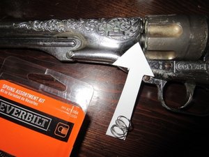

I have a Toy cap gun hubley colt 45. Like to lern how to fix the cylinder pushplate so the cylinder rotates when you cocked the toy gun

I seem to have fixed mine. I got an assortment of springs from Home Depot by Everbilt. Picked a light-weight compression spring, about 1/2-inch in diameter, and 1/2 inch long, and inserted it between the barrel and the cylinder (with the retractable rod through it). That exerted enough pressure to hold the cylinder against the little lever that pops up when the hammer is pulled back, allowing it to connect with the pegs on the cylinder. If it gets hung up, grease the thing with petroleum jelly.
Not sure what are the “spring & feeder plate” you mentioned.
I think the problem is a rare design flaw by Hubley.
Hope this works for you (and continues to work for me!). By Leonard Hughes (11/29/2018)
hope this image comes through.
I believe the trigger cylinder feeder plate is that shown in the attached photo with the related spring. Both parts mount on a post at the bottom of the hammer piece. The spring forces the prong end of the plate to the rear end of the cylinder where it engages to index the cylinder position when the trigger or hammer are pulled. There are only a couple of ways the spring can go, so try them both and go with what works.
