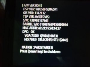

This message appear when turning on the camera.
Also, the computer can’t recognise the USB.
Please, what is the reason?
