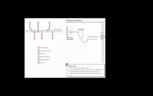

Why won't my Polaroid S10 tablet charge?
I left my tablet charging for 4 hours and it still has not charged from the micro USB port?
Is the port on the right, or USB port the charging point
The micro USB port on the tablet is not specified as the charging port. Rather, the smaller round port to the immediate left of the micro USB port is the designated charge port for the Polaroid S10 tablet. Try plugging the charge cable associated with that port into the tablet and see if the tablet charges once it is plugged into a power source.
Hi @vicz7,
Here’s an image taken from the user guide that shows how to charge the tablet.
(click on image to enlarge for better viewing)
