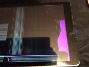

I am replacing an LCD on an iPad air but once the new LCD is hooked up the device will not power on. To check to see if maybe the port on the motherboard got burnt out, I hooked up the cracked LCD and was able to power it on and off. I then figured that the new LCD itself was bad. SO I returned that one and ordered a new one and the same issue persists. I tried holding the home button and power button as well. Any ideas?

I'm having the exact same problem. It will not power on after the lcd replacement. One thing I did notice is that it would power on with the old lcd and while it was turned on, I could put in the new lcd and it displayed just fine. Once I power it back off, it will not power back on unless I put the old broken lcd back in. Any other ideas anyone?
I am having the exact same problem...... there must be either an issue with certain lcds or apple has coded the original lcd to the motherboard.
i have done lcd replacements on ipad airs with no problem before but this ipad is only about a month old so am wondering if apple has maybe coded the newer ipad air lcds.
Same problem! I'm on the 3rd new LCD and won't pwr on, but when I place an LCD from another air it works fine! I try the new LCD's in both devices with no luck. I buy from a highly respected vendor that only carries top quality parts.
any tried a full restore on the device?
No. I just installed the lcd I bought that was taken off of a working iPad Air and it worked fine.

This issue is because of a firmware issue. The point of manufacture did not flash the appropriate firmware to the LCD. You need to replace the LCD with a new one - but maybe from a different vendor so that the chances of the problem repeating itself is reduced.
Thanks. That's the same conclusion I've come to. I'm going to try a take off from eBay hoping that this feedback will help my vendor straighten this issue out.
So these lcds are useless or will they work in some iPad airs and not others?
I'm RMAing 2 of them just incase. The vendor says that this isn't a common problem. I'm thinking this maybe an issue on newer models that have been coded like you suggested.
It's really annoying, I have just had another LCD from a different vendor with the same outcome. Is there any way to distinguish which ones will work and which ones won't.
eTech parts is aware of the problem and sending existing inventory out to have them flashed with correct firmware. In the mean time I bought a used LCD off of eBay and it worked.
I have replaced the digitizers on ipad Air before with no problem but this time we had one with cracked LCD screen. Replaced the screen, but it stayed black. With the old cracked screen light was coming on and could see the image. As our distributor was only 20 miles away so I took the device to their office and tested with 4 more LCD screens. They all stayed black. They were also from the same manufacturer with same numbers at the back.
Decided to order from a different supplier. It worked. So obviously the problem was with this distributors screens. I contacted 5 different suppliers on ebay and aliexpress regarding this issue. They all said that they never had any problems with their screens. I bought from another supplier (Kamani, Slough, UK) on ebay who has sold about 73 so far ( £ 60 / unit ). Some people claim that these lcd screens are coded by Apple but it is not true. There are some screens in the market which just don't work at all.
During all this process I had one more problem which just appeared from nowhere. Although this was not originally the problem. When replaced the screen, ipad would not charge. However, it was charging fine before. It was making beeping sound after about 8 seconds and would also not switch on. Took the board out as it is just glued to the case. Checked all the connections and they all looked fine. Just left it for about 24 hours. Then pressed the power button and it switched on. Maybe it was holding some kind of charge which got released. It was fine after that.
Had some very painful few days but wanted to share my problems here so that it might help someone.
