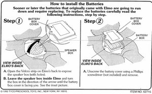

Where is Location of Elmo's Activation Box Cover?
AAA batteries needed in Activation Box.
Karen Dee Koza, Elmo actually uses 3 AA batteries. check the images to show you where the batteries are and how to replace them. Hope this helps, good luck.
I cleaned the battery connections in the compartments with Emery board and then inserted the new batteries. 2005 model works like new.
