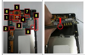

1. Take connectors & Side Key FPCB (1~9) out of the Main PCB
2. Widen the gap between Front cover and main PCB

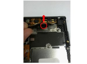

3. Remover the Bracket Camera to upper
1. Unfastening the hook from below side, sh back side of LCD through a hole on back side of Front cover
2. Take apart Frame out of Front cover
1. Lift LCD from the frame & Take off the LCD.
2. Be careful. Do not tear the LCD FPCB
