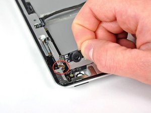

So I had to replace the screen and during the process I ripped the wifi antenna. I ordered that and put it in no problem. Now before applying the Adhesive Strips I wanted to make sure everything worked. I tired holding the power button and it won't turn on (yes all the ribbon cables are attached). I plugged it into a power supply and it booted and the digitizer seemed to work ok, but not the power button. To turn it off I had to unscrew the logic board and lift it from the battery packs. Any ideas?

Hey the home button prob is nothing to do with the power button. There are two very small metal pins by the area the home button sits on the cable connector. One of these or both have been knocked off while replacing. You need a new cable connector unit.

Agree with the other answers here. The ribbon cable is exposed between the volume-lock button and the power button and is very susceptible to being torn. Especially if you are not using caution when lifting the digitizer off originally, I've done it plenty of times.
I even had the ribbon tear in the same spot just from touching exposed adhesive. As soon as I lifted the digitizer to reposition it, the adhesive grabbed the exposed ribbon and ripped it right off. I circled where to look below.

Another issue I have run into is if you tighten the screws down too tight on this cable (be it the volume section or the power section) the buttons wont work because they dont have wiggle room. You might want to get below the rear-camera and try loosening the two screws holding the power button just a tad. One turn out, one turn in; just try to play with it a bit to see if it works.

Weird. Your cable does look to be in tact, and I have never seen one have issues if it was never replaced. I have installed new volume cables only to find out after that they didn't work (despite looking fine). My only advice would be to replace the volume cable. The cable itself is cheap but it is the worst thing to have to replace on an iPad IMO.

You probably ripped the power cable as well. I bet you anything that the volume control still works but the power button does not (it's part of the same cable) due to the placement of the power cable it gets easily damaged unless you know where to be careful.
I'd suggest replacing the power/volume flex cable. They are very delicate and sometimes it's difficult to tell if they are broken just by looking.
The only other thing I'd try is to adjust the two screws holding the power/lock button down. Sometimes if they are too tight it will restrict the use of the button. I will say though that this remedy is more successful for the volume up/down buttons than the lock button.
If you chose to replace it yourself, I'd suggest buying a couple new cables just in case. They can rip easily while they are being installed if you're not careful. Also, about 1 out of 10 will be dead in my experience so it's always nice to have another one just in case.
