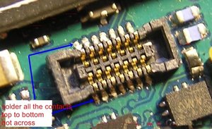

The tiny piece in the image came off, I fixed it with some superstrong glue and pressed the contact on both side down. Before try to recharge it I would like to know if there is danger, could it oxidize? and if yes, There is something that I can put on to isolate it from the air?
crwdns2944067:06crwdne2944067:0
Could you place an arrow or some other marker on the piece that has come off? Difficult to determine which part you are looking at. Oh, are you talking about a torn connector of the flex cable that is now stuck in the connector on the logic board?
Added image, I don't know how it should be named but is that! :D
Giovanni Riva, just to clarify. the connector came loose on the board?
yes, I re-add it with a (very) little bit of superstrong glue. Don't ask me how my brother did it! :D
Trust me, things happen all the time ;-) I don't think the glue is going to get it resolved. You will have to make proper contact for it to work. Check my answer
Giovanni Riva, looking at the images and checking where you said you applied glue, it appears as if your connector came off the board. Yes, it looks like you have enough of the original contacts left that you can solder it. Leave it the way you have it right now and apply solder bridges with a very fine-tipped soldering iron. The glue may not support the points making contact. Hope this helps, good luck.

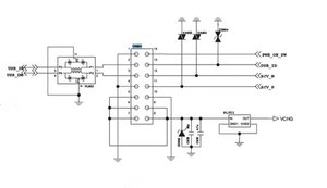

The connector is CN904 : Upper FPCB Conn1.
- no Power on
- no USB
- no Receiver
The schematic may be what you are looking for to determine which pin does what. It is not as easy as just positive and negative connection :-)
I would definitely suggest to purchase a fine soldering iron and get the connector resoldered. It'll be a 5 minute job for someone :-)

Is it absolutly necessary? I have a solder but it isn't thin! And what you mean with "solder bridge"? this http://www.ustr.net/smt/smd006.jpg ? So I can mix the pins? thanks!
NO solder bridge from the bottom of the contact to the connector, not across. Sorry , but I do not think there is any other way but to solder it back on. A 15W-30W soldering iron with a small tip should get this soldered. Use a small soldering tip and do not use a soldering gun.Practice on some old logic board first. Only you know your limitations, but practice makes perfect ;-) if you are unsure about doing this yourself, check with a local repair shop and see how much they might charge you.
