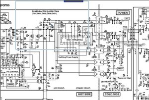

The projector doesn't switch on. Had the power supply replaced a few months ago to solve this problem and it worked for a bit after that but it's given up again. Can anyone advise or provide a service manual?

David Hicks, I'd definitely check the power supply first. Of course, start with the fuse F601 and R661 on the logic board. BTW,here you go :-)
Thank you. The manual shows where the components are on the circuit board but refers to the main service manual which, I assume, will show how to take things apart to get at the board! Can you provide that one too?
found the main service manual at http://diagramas.diagramasde.com/otros/P.... Typical: the power supply board is at the bottom and requires almost complete disassembly...

i think the power ic..replace the power ic and then change the new power ic..
Check the connector between the lamp and the ballast for oxidation on the contacts
especially the end of the ballast cord with the connector the lamp plugs into and clean with abrasives.
