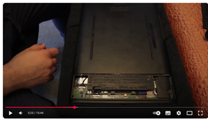

<title><![CDATA[Wacom MobileStudio Pro 16: [Besoin d'aide / Need help] safely opening a Wacom MobileStudio Pro 16]]></title>
<description><![CDATA[<p>(Demande formulée en français plus bas)</p>
<div class="clearer"></div><div class="headerContainer"><h3 id="Section__English" class="header">🇬🇧 English</h3></div>
<p><strong>Need help safely opening a Wacom MobileStudio Pro (DTH-W1621)</strong></p>
<p>Hi everyone,</p>
<p>I’m trying to open my partner’s <strong>Wacom MobileStudio Pro 16&quot; (DTH-W1621)</strong> to <strong>clean the cooling system and replace the thermal paste</strong> on the NVIDIA Quadro P1000 GPU, which is reaching over <strong>100 °C under load</strong>.<br />(Toon Boom Storyboard Pro triggers an <strong>NVIDIA OpenGL Driver crash</strong> and then a <strong>BSOD “VIDEO_DXGKRNL_FATAL_ERROR”</strong>.)</p>
<p>I’ve tried everything software-related (drivers, updates, system cleanup, etc.) but nothing has worked — so I’m now focusing on the hardware side.</p>
<p>I’ve already removed the <strong>back panel</strong> (RAM and SSD access), the <strong>fan section</strong>, and the <strong>connector board cover</strong>, but I’m stuck at <strong>separating the main glass screen from the chassis</strong>.</p>
<p>Before going any further, I really want to avoid damaging the screen or the machine.</p>
<p>Here are my main questions:</p>
<ol><li>Should I <strong>lift the glass screen itself</strong>, or the <strong>plastic bezel</strong> around it?</li><li>Where are the <strong>best entry points</strong> for plastic picks or spudgers?</li><li>Are there any <strong>fragile areas or ribbon cables</strong> right under the glass?</li><li>And if anyone has <strong>photos, videos, or internal diagrams</strong> of the 16&quot; model, I’d be very grateful!</li></ol>
<p>I’ve got all the proper tools (iOpener, suction cups, plastic spudgers, etc.), and I’m taking my time to do this cleanly.</p>
<p>Thanks a lot in advance for any advice or experience you can share — especially if you’ve already opened this tablet or replaced the thermal paste. 🙏</p>

<div class="clearer"></div><div class="headerContainer"><h3 id="Section_Update_10_05_Num_25" class="header">Update (10/05/25)</h3></div>
<p>My model :<br /></p>
<div class="imageBox imageBox_left"><img src="https://guide-images.cdn.ifixit.com/igi/TpvTMOZo4Cx6EVHu.standard" width="169" height="225" class="hasMenu hasLarge" alt="Block Image" onclick="window.open(&quot;https:\/\/guide-images.cdn.ifixit.com\/igi\/TpvTMOZo4Cx6EVHu.full&quot;, '', 'width=1500,height=2000')" /></div>
<p>Video's model :</p>
<div class="imageBox imageBox_left"><img src="https://guide-images.cdn.ifixit.com/igi/ZjJNOOkqhWUlVG4Z.standard" width="282" height="161" class="hasMenu hasLarge" alt="Block Image" onclick="window.open(&quot;https:\/\/guide-images.cdn.ifixit.com\/igi\/ZjJNOOkqhWUlVG4Z.full&quot;, '', 'width=1156,height=662')" /></div>
<p>⟐ Edited by author Oktober 05, 2025 at 11:16 GMT-7</p>]]></description>
