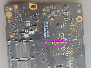

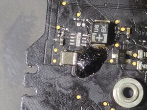

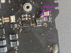

<title><![CDATA[MacBook Air 13" Late 2020: M1 MacBook air lid sensor issue? (it think the lid is always closed)]]></title>
<description><![CDATA[<p>Hello everyone.</p>
<p>I have issues with my 2020 macbook air.</p>
<p>It think that it is always closed. I can't get it out of  <em>sleep</em>  for more than 2 seconds (if plugged in) and keyboard and trackpad don't work.</p>
<p>It works great with external monitor and peripherals.</p>
<p>I tried : new keyboard/trackpad flex cable, new trackpad, unpluggin the screen, le left speaker and microphone array (i saw that the lid sensorS are on the mics / right speaker), tried unplugging every board i could, nothing change.</p>
<p>What can i test now ? Maybe the  <em>soundcard</em>  board ? Can the lid sensor management be bad ?</p>
<p>I'm a bit lost.</p>
<p>Thank you very much !</p>
<div class="clearer"></div><div class="headerContainer"><h3 id="Section_Mise_jour_11_24_Num_24" class="header">Mise à jour (11/24/24)</h3></div>
<p>Here is a video of the problem. <a href="https://1drv.ms/v/s!An9H4f-cLtmDjLNAqSAhwGchG8nRaQ" rel="nofollow noopener noreferrer" title="https://1drv.ms/v/s!An9H4f-cLtmDjLNAqSAhwGchG8nRaQ">https://1drv.ms/v/s!An9H4f-cLtmDjLNAqSAh...</a></p>
<div class="clearer"></div><div class="headerContainer"><h3 id="Section_Update_11_25_Num_24" class="header">Update (11/25/24)</h3></div>
<p>Hello <a class="user-mention-link notranslate" href="/User/408812/DanJ">@danj</a> ,</p>
<p>Thank you for your help</p>
<p>Here is a screenshot of the app (with external peripherals plugged in)</p>
<div class="imageBox imageBox_left"><img src="https://guide-images.cdn.ifixit.com/igi/Z1C23DNvyTHhrWTx.standard" width="228" height="225" class="hasMenu hasLarge" alt="Block Image" onclick="window.open(&quot;https:\/\/guide-images.cdn.ifixit.com\/igi\/Z1C23DNvyTHhrWTx.full&quot;, '', 'width=550,height=544')" /></div>
<div class="clearer"></div><div class="headerContainer"><h3 id="Section_Update_01_23_Num_25" class="header">Update (01/23/25)</h3></div>
<div class="imageBox imageBox_left"><img src="https://guide-images.cdn.ifixit.com/igi/HPUulO2w2Dbrb5Lw.standard" width="127" height="225" class="hasMenu hasLarge" alt="Block Image" onclick="window.open(&quot;https:\/\/guide-images.cdn.ifixit.com\/igi\/HPUulO2w2Dbrb5Lw.huge&quot;, '', 'width=675,height=1200')" /></div>
<p>found it!</p>
<p>⟐ Answer edited April 23, 2026 at 3:40 MST</p>]]></description>

<title><![CDATA[MacBook Air 13" Early 2015: Spilled water on laptop now the battery won't charge]]></title>
<description><![CDATA[<p>Spilled a small amount of water on laptop, I had a cover on the keyboard but some still got in there. I dumped it upside down immediately and then toweled it off. Next I used the blow dyer on low setting for 10 minutes  before I realized our Hepa airfilter has a powerful fan so I put the laptop in front of the killer fan to dry it for 24 hours. <br /></p>
<p>The computer works great — as long as it’s plugged in. The battery always shows 80% but the indicator says “battery is not charging”, and the “Power source: Power adapter”. The light will flash green for a second then stay at orange. <br /></p>
<p>I ran the coconut battery app… <br /></p>
<div class="imageBox imageBox_left"><img src="https://guide-images.cdn.ifixit.com/igi/xjaRhgBEGqeT6odJ.standard" width="169" height="225" class="hasMenu hasLarge" alt="Block Image" onclick="window.open(&quot;https:\/\/guide-images.cdn.ifixit.com\/igi\/xjaRhgBEGqeT6odJ.huge&quot;, '', 'width=900,height=1200')" /></div>
<div class="imageBox imageBox_left"><img src="https://guide-images.cdn.ifixit.com/igi/KBXjNKBMruHjVQYf.standard" width="169" height="225" class="hasMenu hasLarge" alt="Block Image" onclick="window.open(&quot;https:\/\/guide-images.cdn.ifixit.com\/igi\/KBXjNKBMruHjVQYf.huge&quot;, '', 'width=900,height=1200')" /></div>
<div class="clearer"></div><div class="headerContainer"><h3 id="Section_Update_11_09_Num_2020" class="header">Update (11/09/2020)</h3></div>
<p>I had spilled water on my laptop keyboard and it was working perfectly fine it was charging slower than normal but it was working then today I had went to unplug my laptop and it turned of and wouldn’t turn on but as soon as I plugged it in it turned on idk what to do</p>
<p>⟐ Commented April 18, 2026 at 21:19 MST</p>]]></description>

<title><![CDATA[MacBook Air 13" Early 2017: This is a hard one to diagnose... Tried everything.]]></title>
<description><![CDATA[<p>This is really strange, <a href="https://everymac.com/ultimate-mac-lookup/?identify=FVFWV00ZJ1WL&amp;g-recaptcha-response=P1_eyJ0eXAiOiJKV1QiLCJhbGciOiJIUzI1NiJ9.haJwZACjZXhwzmnhjxCncGFzc2tlecUFGfp239T_yBbb2tk87H_R90Lkwd9n6TjFkLfzGBDwwKD5n8gFGqcw1_7VBaeOPXf6cUHR3pq37oFywI5VdCOWj3p1lUY0XZsUYfuBoKE8fo5VEp4YKf1qfyXZZkqEVR3enivuYO5L3K2cMagukmi2EFaA2rYrR4jYEmrS9YMfQletQYLCE2o0DxoANtPmhEZZe3eNxbQqLcwuvQbD9tVQcN4WkIATTSmUpOh6WgFsXCJetA9-s_G1cmgaP9iwc6uvBPyrXscO8bfuQnFZlwxwI57bxqO9B8RW1iDDJ4E1iNGPXHDC582281ep9-_xXKOTZFT-qas3jywj7YP_VcL5XHPm-VBwNZfy8OT2gU1e2eZ7NZAYE5WZRt0g9kCijTUx3U3JlmAS_X799mb51p6jag-4p8TAdBRaQb4VVbLKrls6O1B1ND8aVVJ3N1cIrZg_7LCRctFbLZVa0ew_YPdfvGutCALlyYKwO8HLIrhuBbfFi09rmuBWv02cgcJtktGMfdjYz2R90UQVFg4fCHYzv_m6kQkAzbdyQb7_EP90KR_qUtxnDlTJkf0irh6Xo6nrm18TKVbDxIF6NOBjfILEFVDvJic667AH5Qvf-bAxbipZjUTkf2Toai3IDMrth2n6N8--99hTIiabLKLi_UY8tC0FtUNvIADP8ZDd25i2XkNRrGRjgLDhnys_KIg4eK_Q1GLw2mk-ozx_Mq6FIOcZ8tnIlheKakzwf-5qtxk1Rj2ysU7F4u75Cxp8RPR-GWDMYk5TDOVLMZJ94mwmwz2MgqBu2m2YagwkMMcD-xWSm8IM_fwS3f1sZUR8UdRQUJeqMFFCj1nKPEEhRbB6po5Ws9bBJqnOmCuDwjvEke5ho3ZhR029Vu3FIYbITgNsl4NIbChPuWA_LryFIG6cvQaq4Fqxp0gPtWJPm3oVSY0rFgXFgN2YIiMXt6-uCB5yuCBDtdETdtYizyTXRpM5T6dcYEgLrOUF1kwhjiPUwEQhneuwbtZ0tm9XzB5uIZsw9FQdxHOj6ncEvPgCWdXZSlv-AGOjoiUO4IT8WfAyBuJc8I0ujpmHen2fpphbKhK5ikj8H6HlBSjK2BOdindY0_-IYutVjScW2N-ZZKXyhYlIWAY1VABvKAOn8g_Zpjn8K-_whOoTGRjPxK-OsrPjTlGyWaVz-xj1n2IrKlyDMND27xTmN6qY8YFgois08kKupvvTtfIUzR6VQdG1BO4--p_p9DDTV_dnXgYAu5L8MNkrJGdJVqURbdykM-TGueyq8yq5rK8twUHFYo4xqMvCJ2_ikf-RVKfTI07KRtkkkVrUlV3k6IW6ss3nUN1ktIaFEC8Nz96k02sg-nOriMrkwzDhlCduMBWE6viORHYJZQ6dtZFlh8KWRR90lE3z2nJWgwB3Eya7uJh7metqBk5ik7Ul32ZjhWCQl8SrYoi6vw36h9bXdwPxUVjC0Fm8DI4p7fujWT4hhqixK7Ryik6w4td0G8yOLS52Yq5W7TQMaaogEQyqU-QMs6eIQhPwsYftYycVUoeBgqbGjHpnXJia3Yjdxp0GlpSWqA13VT8f9lPLY_BjNOqtKxn652NZvSZrXy9uE2IsxOWjAPMimXhLJ1d1g_0E2TCGL_YSdqvODcevZ5M2BiO31im831L-meO4s1S2f5OEosQjr3KLxvpBvqih_hWpOcWPJ0MMEMcibbIS-9O8CCJrDfZ31ePd175wEd8f3ZZM6oD4NOQo1qJrcqgxZjdiNzM2NahzaGFyZF9pZM4VmeRU.UOdaTndT2uwZdAtVp2x3uEUuhpN8fw8gfBFFj5u9KKc&amp;h-captcha-response=P1_eyJ0eXAiOiJKV1QiLCJhbGciOiJIUzI1NiJ9.haJwZACjZXhwzmnhjxCncGFzc2tlecUFGfp239T_yBbb2tk87H_R90Lkwd9n6TjFkLfzGBDwwKD5n8gFGqcw1_7VBaeOPXf6cUHR3pq37oFywI5VdCOWj3p1lUY0XZsUYfuBoKE8fo5VEp4YKf1qfyXZZkqEVR3enivuYO5L3K2cMagukmi2EFaA2rYrR4jYEmrS9YMfQletQYLCE2o0DxoANtPmhEZZe3eNxbQqLcwuvQbD9tVQcN4WkIATTSmUpOh6WgFsXCJetA9-s_G1cmgaP9iwc6uvBPyrXscO8bfuQnFZlwxwI57bxqO9B8RW1iDDJ4E1iNGPXHDC582281ep9-_xXKOTZFT-qas3jywj7YP_VcL5XHPm-VBwNZfy8OT2gU1e2eZ7NZAYE5WZRt0g9kCijTUx3U3JlmAS_X799mb51p6jag-4p8TAdBRaQb4VVbLKrls6O1B1ND8aVVJ3N1cIrZg_7LCRctFbLZVa0ew_YPdfvGutCALlyYKwO8HLIrhuBbfFi09rmuBWv02cgcJtktGMfdjYz2R90UQVFg4fCHYzv_m6kQkAzbdyQb7_EP90KR_qUtxnDlTJkf0irh6Xo6nrm18TKVbDxIF6NOBjfILEFVDvJic667AH5Qvf-bAxbipZjUTkf2Toai3IDMrth2n6N8--99hTIiabLKLi_UY8tC0FtUNvIADP8ZDd25i2XkNRrGRjgLDhnys_KIg4eK_Q1GLw2mk-ozx_Mq6FIOcZ8tnIlheKakzwf-5qtxk1Rj2ysU7F4u75Cxp8RPR-GWDMYk5TDOVLMZJ94mwmwz2MgqBu2m2YagwkMMcD-xWSm8IM_fwS3f1sZUR8UdRQUJeqMFFCj1nKPEEhRbB6po5Ws9bBJqnOmCuDwjvEke5ho3ZhR029Vu3FIYbITgNsl4NIbChPuWA_LryFIG6cvQaq4Fqxp0gPtWJPm3oVSY0rFgXFgN2YIiMXt6-uCB5yuCBDtdETdtYizyTXRpM5T6dcYEgLrOUF1kwhjiPUwEQhneuwbtZ0tm9XzB5uIZsw9FQdxHOj6ncEvPgCWdXZSlv-AGOjoiUO4IT8WfAyBuJc8I0ujpmHen2fpphbKhK5ikj8H6HlBSjK2BOdindY0_-IYutVjScW2N-ZZKXyhYlIWAY1VABvKAOn8g_Zpjn8K-_whOoTGRjPxK-OsrPjTlGyWaVz-xj1n2IrKlyDMND27xTmN6qY8YFgois08kKupvvTtfIUzR6VQdG1BO4--p_p9DDTV_dnXgYAu5L8MNkrJGdJVqURbdykM-TGueyq8yq5rK8twUHFYo4xqMvCJ2_ikf-RVKfTI07KRtkkkVrUlV3k6IW6ss3nUN1ktIaFEC8Nz96k02sg-nOriMrkwzDhlCduMBWE6viORHYJZQ6dtZFlh8KWRR90lE3z2nJWgwB3Eya7uJh7metqBk5ik7Ul32ZjhWCQl8SrYoi6vw36h9bXdwPxUVjC0Fm8DI4p7fujWT4hhqixK7Ryik6w4td0G8yOLS52Yq5W7TQMaaogEQyqU-QMs6eIQhPwsYftYycVUoeBgqbGjHpnXJia3Yjdxp0GlpSWqA13VT8f9lPLY_BjNOqtKxn652NZvSZrXy9uE2IsxOWjAPMimXhLJ1d1g_0E2TCGL_YSdqvODcevZ5M2BiO31im831L-meO4s1S2f5OEosQjr3KLxvpBvqih_hWpOcWPJ0MMEMcibbIS-9O8CCJrDfZ31ePd175wEd8f3ZZM6oD4NOQo1qJrcqgxZjdiNzM2NahzaGFyZF9pZM4VmeRU.UOdaTndT2uwZdAtVp2x3uEUuhpN8fw8gfBFFj5u9KKc" rel="nofollow noopener noreferrer">This 2017 MacBook Air 13&quot;</a> has a mind of its own.</p>
<p>I boot it up to what I believe was an SSD with Monterey on it and I get either a no entry sign OR I get this.....</p>
<div class="imageBox imageBox_left"><img src="https://guide-images.cdn.ifixit.com/igi/ppbGrxlitAmsOMS3.standard" width="282" height="215" class="hasMenu hasLarge" alt="Block Image" onclick="window.open(&quot;https:\/\/guide-images.cdn.ifixit.com\/igi\/ppbGrxlitAmsOMS3.huge&quot;, '', 'width=1571,height=1200')" /></div>
<p>This suggests to me that the keyboard or Track Pad or both isn't detected, Yet the power button is working to turn it on and off, but it won't do a PRAM reset..... So I swapped over a new cable and it is the same. All I can do is connect a USB mouse and I get language option OR start up disc.... I checked the start up disc and I get this!</p>
<div class="imageBox imageBox_left"><img src="https://guide-images.cdn.ifixit.com/igi/qMo1E5vFCmHxYnwL.standard" width="282" height="117" class="hasMenu hasLarge" alt="Block Image" onclick="window.open(&quot;https:\/\/guide-images.cdn.ifixit.com\/igi\/qMo1E5vFCmHxYnwL.huge&quot;, '', 'width=1600,height=666')" /></div>
<p>(10.10.5 Yosemite is NOT even supported on a 2017 model as they were originally shipped with Sierra 10.12).</p>
<p>I swapped out the SSD to a KNOWN SSD with Big Sur (Supported) and it is the same, telling me the OS on the SSD is Yosemite!. I thne put another SSD with Monterey pre installed and left at set-up and guess what, it STILL is the same telling me it is Yosemite! I can only think to just put the board into another case with a new keyboard and see if then I can wipe it clean and then to install fresh starting from High Sierra to Catalina, to Monterey (Safest way to get the correct boot ROM firmware installed.... I have NEVER used Yosemite OS and I am absolutely 1000% certain this had either Big Sur or Monterey installed on it's SSD which had not been removed or replaced or anything. Very odd, never seen something like this before. The board is clean, no water damage or anything obvious. Can anyone tell me what and why etc is going on here?</p>
<p>I swapped over the KB case and got into recovery and tried to install Monterey but all I get is a no entry sign..... PRAM was reset. Then tried with Catalina, the progress bar completed and so far so good.....I got into disc utility, selected show all devices and the internal SSD (KNOWN to be good) is not shown. Apple disk image &amp; OS base system only appears, together with the external installer drive. YAY. I put back the 'Yosemite' SSD and it is recognized.... Attempting to install Catalina.... It is seemingly much slower than normal. It gets to disc utility and the internal SSD is NOT detected, again just the base system. I am running diagnostics and the report says SMC <a href="https://support.apple.com/en-ph/102334" rel="nofollow noopener noreferrer">error codes</a></p>
<p>PPF004 (Fan) PPF003 (Fan)</p>
<p>VFD004 &amp; VFD 005 (There may be an issue with the display or graphics processor.)</p>
<p>NDC001 (There may be an issue with the camera.)</p>
<p>PPN001 (There may be an issue with the power-management system.)</p>
<p>VDH002 (There may be an issue with a storage device.).</p>
<p>Everything is connected up fine. I then run the Paul Daniels SMC Tools and successfully updated the SMC. Booted up again and it went back to this screen showing a mouse to connect!. Only option was to select start up disk (Listed were 4 compatible systems from my multi OS bootable drive, I selected Catalina, restarted and I get the screen your computer has a problem. Yes I know LOL</p>
<p>Firmware password protection is turned OFF. Help!</p>
<p>UPDATE: We have put a new SMC chip &amp; programmed it with SMC tools. We have swapped the BIOS chip from a 2017 donor board (But we are looking for a BIOS file to program it fresh if need be).... We swap out SSD's with compatible OS (Monterey) but are always greeted with a flashing folder and a high spinning fan. <a class="user-mention-link notranslate" href="/User/263105/oldturkey03">@oldturkey03</a></p>
<p>⟐ Commented April 17, 2026 at 3:43 MST</p>]]></description>
